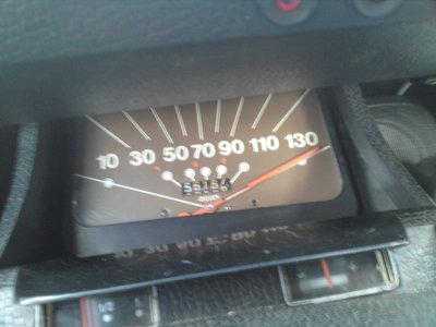

I have had 2 Dyanes - this one 1976 and my first 1979. Both had Jaeger speedos and both extactly the same 0 to 130 kph. I have just received my 2CV magazine and in there is a 1977 Dyane with speedo 0 - 140 kph. The thing that confuses me is the line on mine which is 10 is 20 on this one and the 130 is 140. Would this car have a different gear drive for the speedo and WHY the difference. Any ideas :) :)

Not sure of the WHY, but my acad is 20-140, and i think my dad's is the same.

Seriously, there is no difference in drive, cable or gearing it's just the face, could not detail years or reasons, can assure that they are entirely interchangeable, with 4 Acadianes in my 'parc' I shall now have to examine for differences.....

Roy,
maybe Dyane 4?
Because of different cogs inside the gearbox, the take-off gears for the speedo drive in a 435 box are 3/14 instead of the 602's 4/16.

French Dyane club is always rather good on Dyane differences and is slightly ambiguous after 1977:
http://dyaneclub.free.fr/?page_id=489
