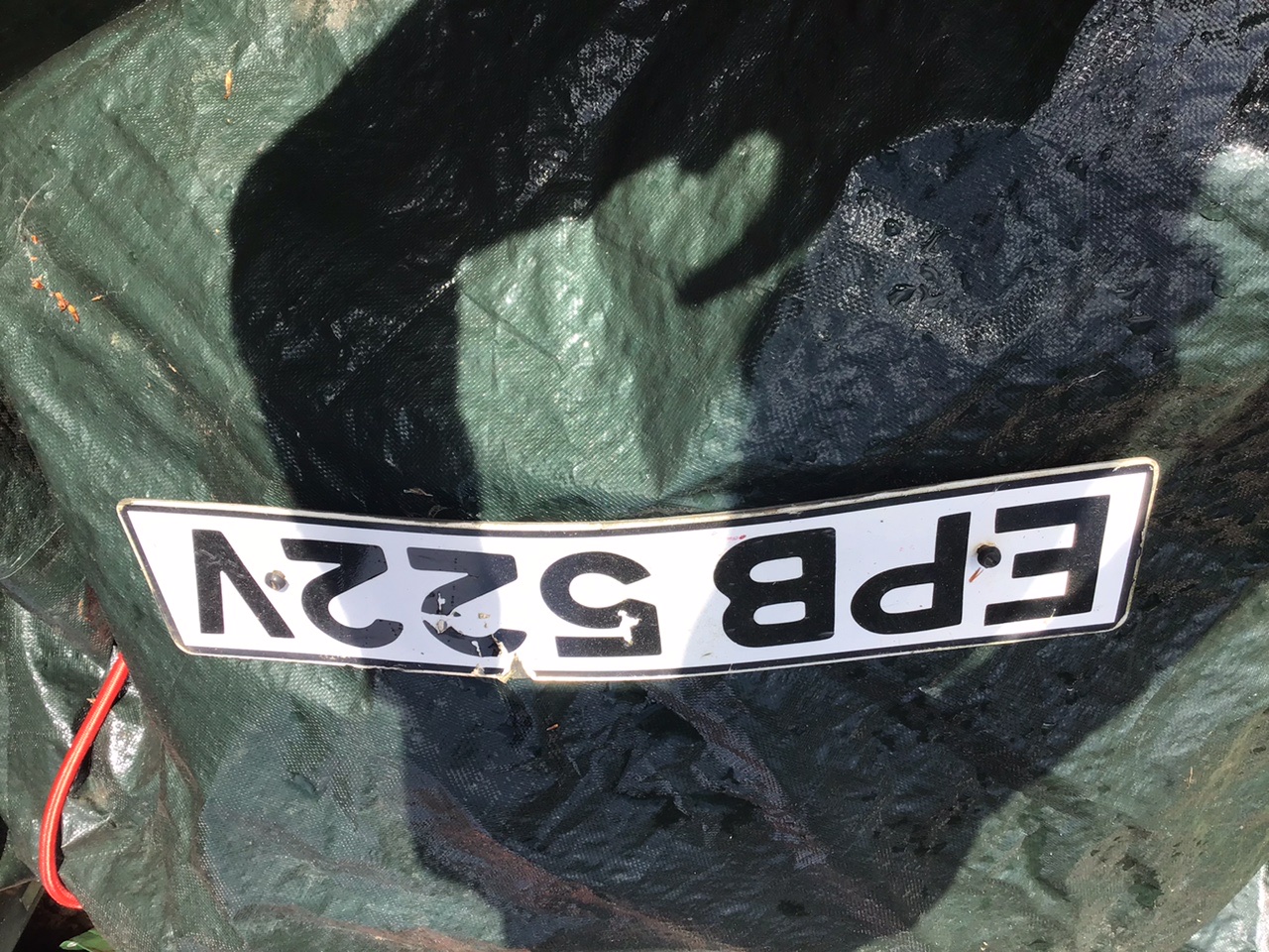

what is an EPB?

Post Re: EPB Refurb
Abbreviation of Exceeds Planned Budget

Well! if your going to build it up-side-down, I'm not surprised!
