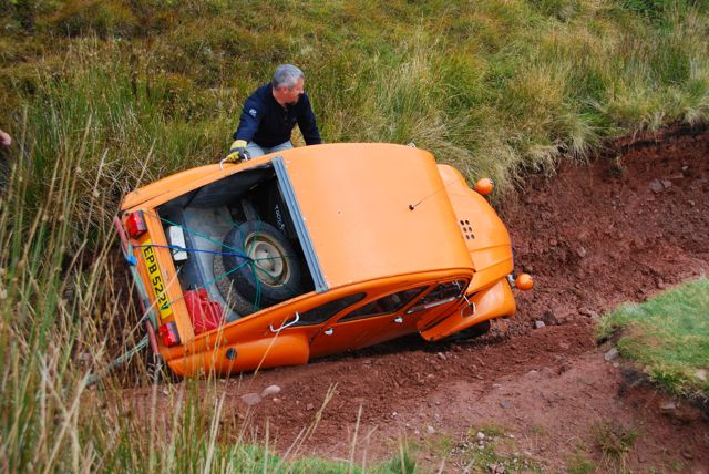

I like the picture! At least with a 2cv rolling over, the damage is likely to be less severe and two strong fellows could probably right it. That is one of the attractions to the 2CV 4x4 for me, the light weight keeps it from sinking so deep in deep snow and or mud etc and makes recovery much easier. After having bogged a Unimog 406 twice this winter in deep snow, I am ready for something lighter. As I get older, I value subtlety more and more.
There will be big differents between your mog and a 2cv4x4. The dissadvantage of a 2cv is the gearing which is never as low as you want it to be. Buy some lower gears they give you more then a diff lock does, but even then it is to high. A Mog with crawling gear is unbeatteble, but when a Mog boggers the 2cv will still "float" and go on.
The 2cv in the picture is a self made SAHARA (2 engine's) it's the cheapest way to go 4x4 in a 2cv....

LPGO is the falling over from "Morvan"?

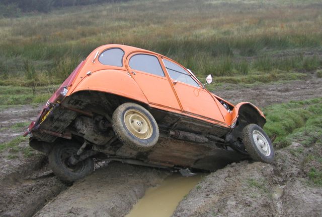

From past outings Diff Locks should only really be used when you are stuck!!.
No this is at Bilstain Belgium http://www.rdmcbilstain.be/
Look at the guy peeing but he doesn't want to miss seeing my Sahara climbing the slope :lol: :lol: :lol: . (Probably my front engine doing 6000 rpm and my rearengine 2000 or so)
This will be almost 20 years ago.
I will post more picturs in my SAHARA lookalike topic
