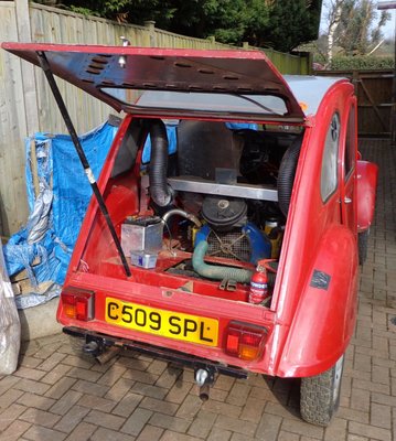

Had a delivery the other day.
The guy asked "Why have you got a wood-burner in the back of my 2CV" :D :D :D
January 2nd, 2016, 1:50 pm
Looks more like a wood chipper to me :P :P :P

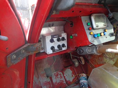

Quite sunny and warm this morning so I mounted the Suspension Control Switch box.
Accessible, but out of the way also.
