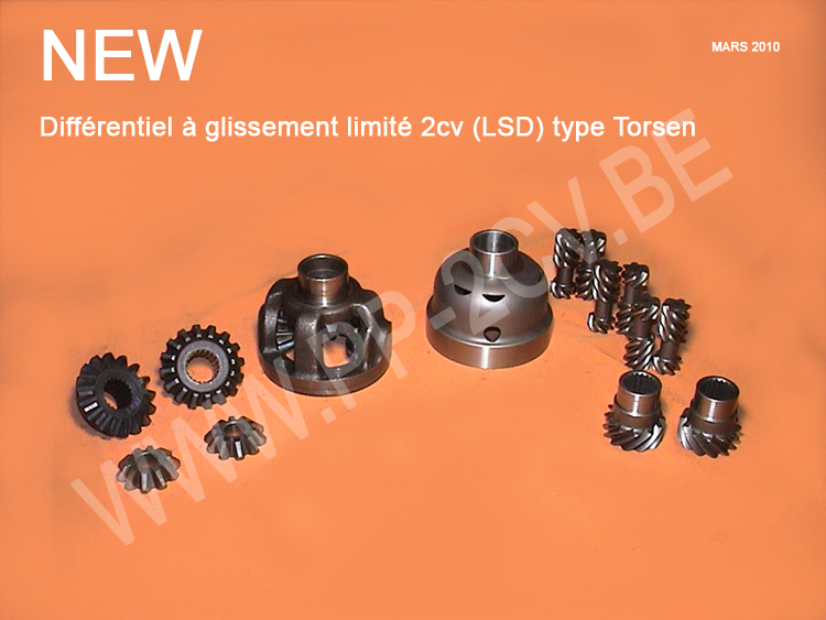

Has anyone had experience with Andre PP's torque bias LSD? (Google Translator required)

This maybe a photoshop job/Seems to only to deal with French speakers.
ATB/Torsen diffs. See http://www.quaife.co.uk.
LB is sole agent for 2CV, I believe he has sold quite a few.

Quaife LSD i sold some to Austria
there the boys( i believe) are making a mod to make this item fit GSA box etc
so the solution / adaption is probably out there
moreover if there is a demand i could probably get Quaife to build a batch of 10
with either splines to suit 2cv or GS GSA out put shafts
cost is in the region of £700 to £750 ish
Actually i am thinking of using a GSA diff in Future Barbour 4x4 (rear only)
and would almost for sure fit an LSD + Full diff lock as option
Quaife really do work Re grip
however the biggest advantage is the partial lock up is gradual so no smashing of very expensive gearbox parts
since we installed them 2 years ago NO broken boxes and already something like 80 to 100 sold!

That sounds great! I would defiantly be in for a group order and will do my best to find others that are interested.

Having spoke to a mechanic who used to work with Eaton on the True Trac diff he said that if "ya pop a mono" (an anomaly where on wheel is suspended in the air) applying pressure to the brake will transfer the 30/70 split to the other wheel, giving you traction.
Lets hope he is right!
I just spoke to a diff expert here who said it would be a pain in the ass to produce an LSD for the GS, looking at adapting one from what is already available. He gave me the info on the GS spline I gave him, but it's 700k's away atm, 21 spline i remember.
