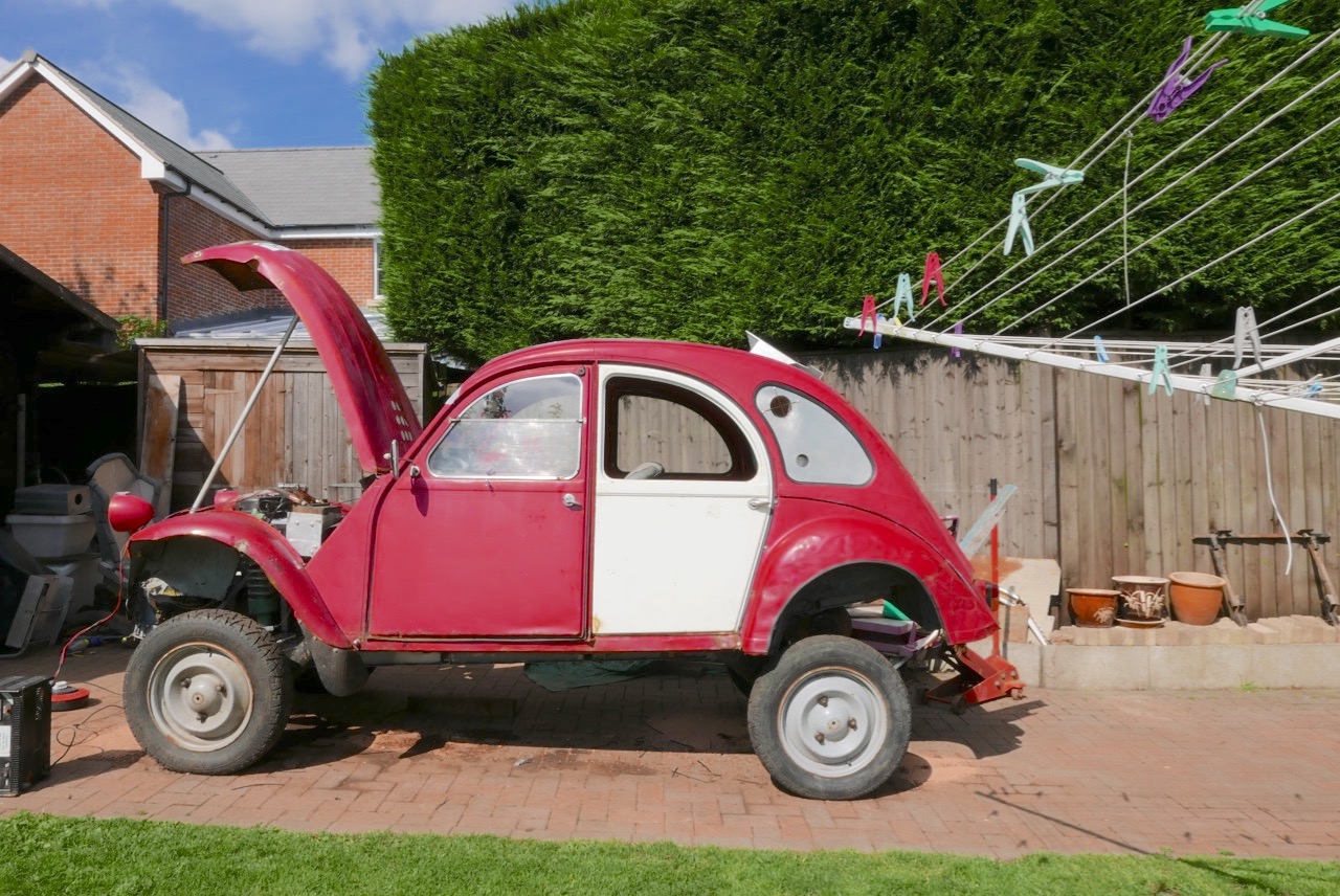

The "Beast" rises again.
Must be the sunny weather :)
