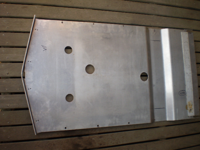

this one's we make for some tourag trail drivers
front and back protects.
they look nearly :D

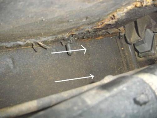

How to inspect the chassis.
2CV chassis are very good at hiding the rust. They are rusting from the inside and out, sometimes with no visible signs.
It can be very stressful to bend a chassis in the middle of nowhere and think that the car will be abandon. That is not going to happen. Check the chassis all over in particular here for a ripple. The side rail should be straight flat running your fingers along side the chassis. If you find a ripple don’t reinforce the side section. It simply can’t cope and is very likely to collapse during the raid. Fit a new good quality chassis and all your worries are gone.
If you see a gap here, the chassis is ''KAPUT''

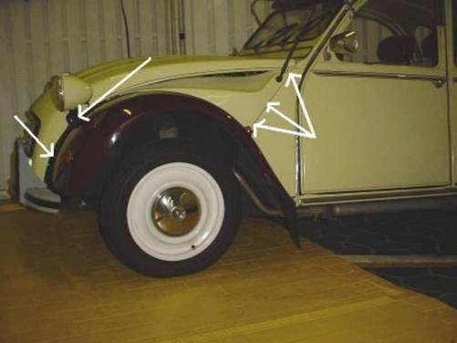

When planing this raid it is our aim, that we should find some of the most difficult roads to travel along.
Roads in the Sahara might start up as a quite OK unsurfaced track, but after a shorter or longer time you may find it difficult to find the track at all, you will find yourself crossing dried out rivers and that can be a task including quite difficult off road driving, sometimes you might have to give up and go further up hill searching for a place with less steep banks.
A 2cv has thanks to its: low weight, low ratio 1. gear and the interaction-system, that allows big independent wheel travel, and (compared to the weight) big wheels, very good off road capabilities.
Meaning that you can pass difficult places rather slowly meaning less risk for damage.
You can improve this by raising the ground-clearance to maximum allowed for a Méhari. Remember to adjust the bump-stops at the same time.
Bigger ground clearance and raised bump-stops also reduces the risk of hitting stones and bending the chassis, if you go to fast-
But you are in the desert and you shouldn't go to fast.
Quitting the front and rear bumpers improves your attack and departure angel. Plus it saves weight+++
A front-buffer with a steel or ALU sheet-metal bending up to the bonnet may help you not getting to much dirt and water into the fan
Tube type bumper like the old P.O. type front bumper are god even though some of the latest were made with a tube that was a bit to weak to use for lifting the car. Be sure to fit it at as high as posible.
This bumper is lighter and much better (stiffer) bolted to the chassis than the standard ones.
Those bumpers sold in the 80. as safari-bumpers are in my opinion to heavy and not proper bolted to the chassis + it reduces your attack-angle,
Don't use to heavy materials if you decide to build and use bumpers.

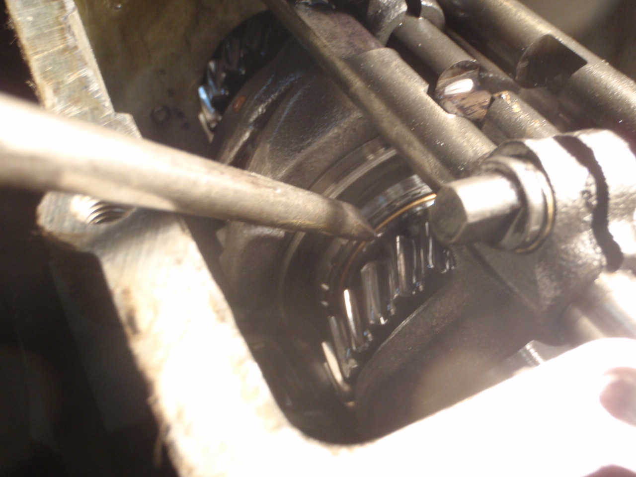

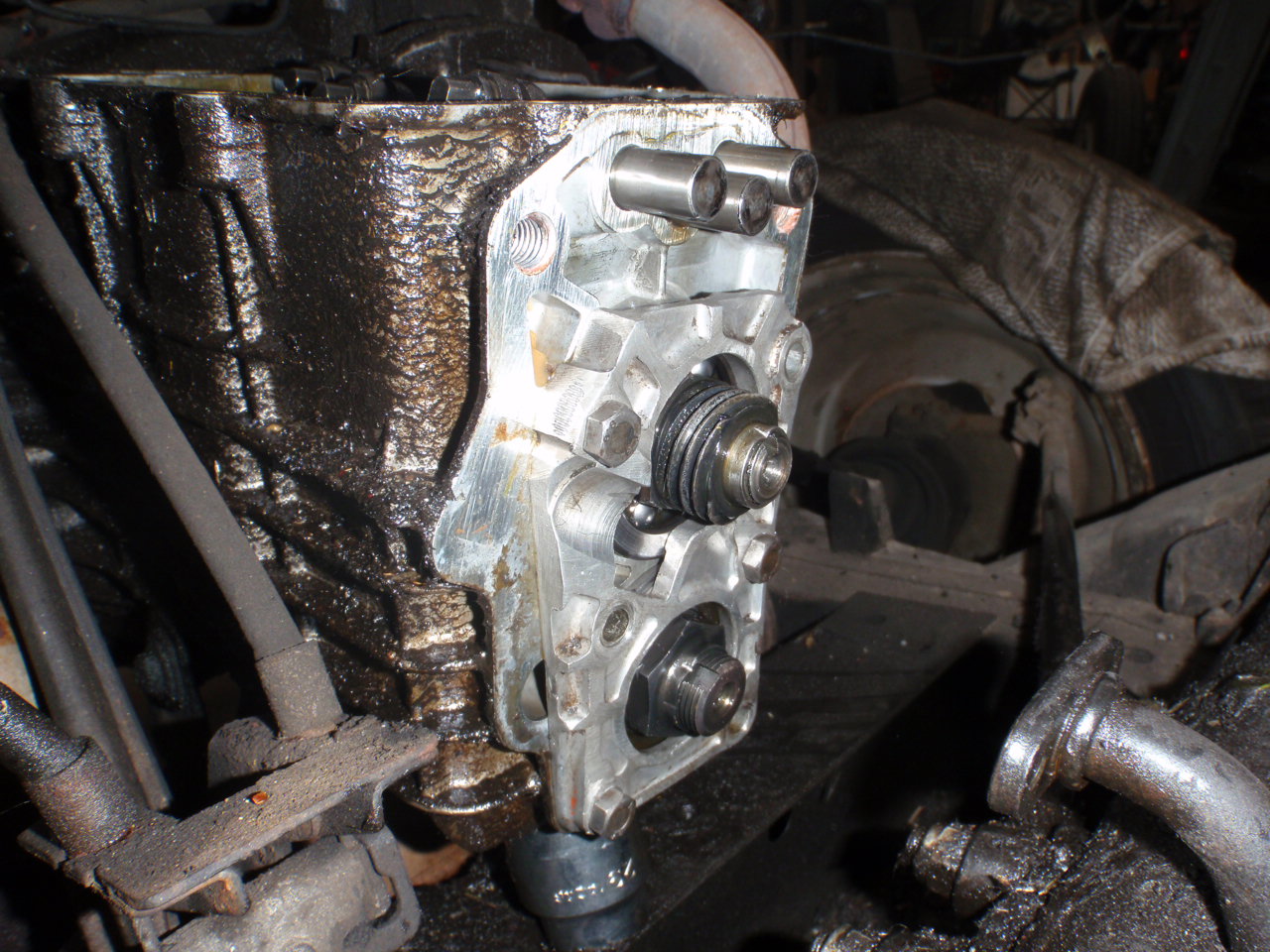

What to do on the gear box. Being bogged in sand is a potential recipe for disaster. It is very important to lock the selector ring on 2nd/3rd sliding pinion and to tie the 2 rear nuts behind the rear cover. If you don’t know how to, have it done by someone in the know.
Apart from that, look at your gear box mount, boot on the gear lever and the 2 rubbers on the lever joint.
Sand is a perfect killer of all metal, best kept away from the gear box. Make sure that the bash plate underneath doesn’t allow sand reaching the gear box and in particular the clutch.
Add fresh gear oil and bring same oil just in case you need to drop the oil.
